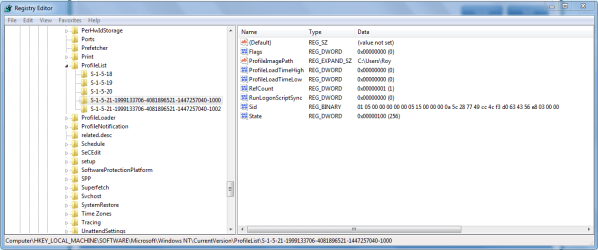

Hi Xiulie,
can you navigate to this location, see screenshot (bottom line), and copy paste yours please.
i strongly suspect you have been infected

Hi thankyou for helping
here it's what you need from my computer
btw, how to upload an image without url? can't attach?
in my regredit just have
(default)
default
profilesDirectory
ProgramData
Public
and everything in red colour..
what I must do again?
