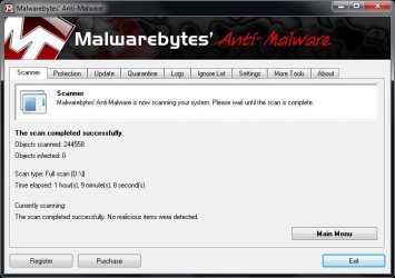

And for the benefit of anyone else who likes to remove a drive from a problem computer and scan it from a clean computer, this exploit is NOT picked up by Malwarebytes, EXCEPT when it is running on the system drive. To clarify, here is the result of the Malwarebytes scan of the drive attached as a slave on my computer.

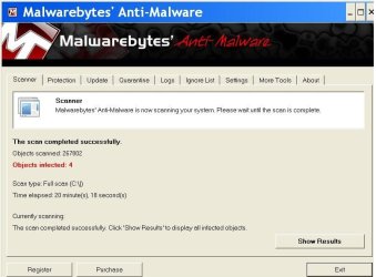

But here is the result of a Malwarebytes scan run with the drive running as the system drive in its own box.

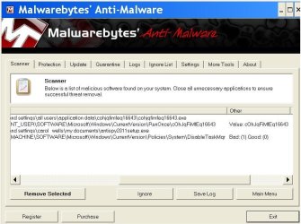

And for anyone who is interested in these things, if you compare the screenshot below with the one in Carolyn's link, you will notice that the file names have changed, and they have added another registry corruption - the disabling of taskmanager.
Ah OK.....yes, that is correct. If you watch the scan progress of malwarebytes, you should noice the first thing it does is "enumerate the registry" or something similar. Since the drive you scanned was a slave in another PC, that PC's registry did not have the corruption, and thus was not picked up by Malwarebytes.
