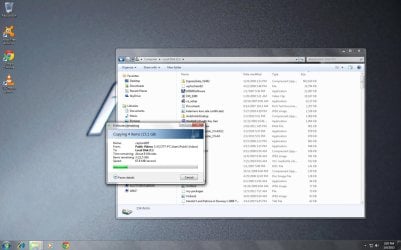

2 windows 7 PC involved direct conneted to each other gigabyte nic cards.
I booted up win7 on the ubuntu PC (dual boots)
And did a large file copy from client win7 to other win7 that has internet. Results were close to 70 MB/sec

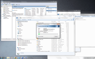

Now it is terrible slow AFTER I enbled ICS on that nic card to share the internet to other win7 PC.
So please explain to me how doing that would kill file copy that bad.
Went from 70 to 10 MB/sec

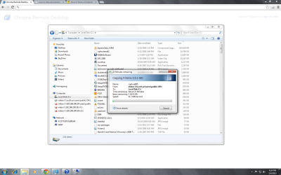

Ok, turned off ICS sharing and verified it was not running under services.
LAN copy speed back up high again, about 100MB/sec
So why is this happening?
