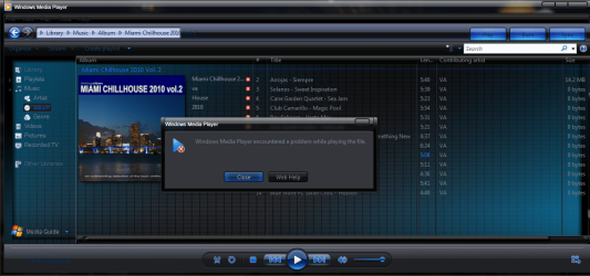

file wont play!
boohbah
1:35 AM
14,252
cornwall UK
ok this mp3 file wont play in wmp any longer, it used to!, it isnt corrupt as it plays fine in xion and vlc , i checked the web info but it says the 1d3 tags may be an issue cant see why its a prob as it played before ,any ideas

couple of ideas:
1) I notice the entire album has the big "Red X of Doom" next to it, is it just that album?
2) could it possibly be a codec issue? did you rip it yourself? if so:
3) did you rip it with another program (like VLC or xion or Itunes) and WMP is just throwing a wobbly because it doesn't like what its done with it?

Have you noticed that in your snip, the size of all the titles on the list (except the one at the top) is 0 bytes? I suspect the mp3s are corrupted.
Too many to describe...
thanks severedsolo yes its just this file, no i didnt rip it myself, it used to play in wmp so i dont get it!
your right bill, i didnt notice before. at this very moment it is playing using xion player so how could it be corrupt, i deleted it from wmp the re-added it but still same prob very odd

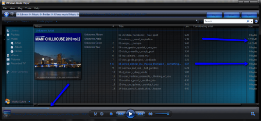

ok i deleted the Id3 tags using mp3tag and dragged the file back into wmp and it works despite all but 2 files showing 0bytes dont really understand but its still a bonus!

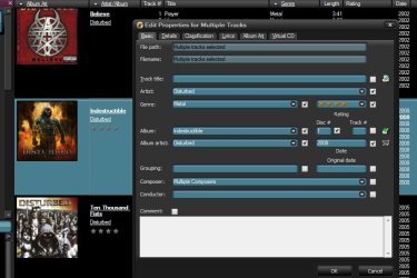

Others may very well disagree with me here, but I have found Media Monkey to be a better tag editor, and excellent for small issues such as this.
Left Click to highlight an entire albumb, then Go to:
Tools / Advanced Tag Management / Clean Id3 and V2 Tags
What I like is, MM will keep the original info temporarily of that Album, although it has been removed from the files.
Next, Right Click the Album and choose Properties.
In the Window place a check mark by the information you wish to keep
(or change it)
You can also add Lyrics & Album Art etc if you want.
When you press OK, it will embed the info into the file. And WMP can read it all, even the embedded Album Art.
*Keep in mind its just showing the info that was there, it has all been erased.
All that it will keep is what you place a check mark on.
