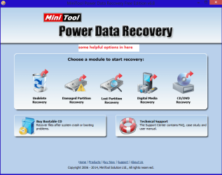

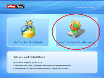

Yup WHS's way is really good and one that I haven't tried yet but might be worth keeping in mind is the mini tools PW - the data recovery section in the start up GUI.

MiniTool Power Data Recovery will only recover 1GB using the free version - for larger data recovery, you will need to use a purchased version.
Yep I had noticed that but still for smaller drives etc it is good at $69 it would not be for me but someone with a large setup not a bad program:)
