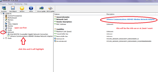

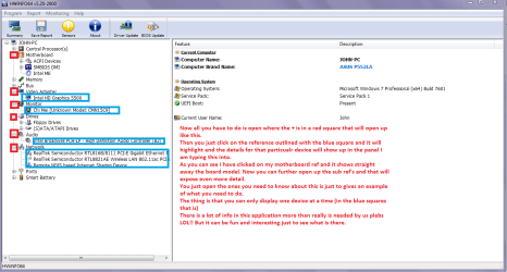

Open each small square with + in it on the section the components are in and then click on the individual component/s (it will highlight in blue) - in the right hand side will appear all sorts of details including brands speeds and other essential info that particular device. See pic for example.

Yep the PSU is fine mate but what I meant by using PART B: was to to go to the individual components - you don't need the Sensor button and when you open each of those components it shows in sometimes very great detail the device and speeds, volts. timings etc etc If you see my pic I'll try and show you how it will look. I hope it makes sense.;)
Now monitors always best go with a brand name one and the size and type I guess is down again to your budget. Personally for general use a TN panel is fine but if you want something fancier an IPS screen is also good but overkill in my mind. For size again your choice but a 24" is a good size.

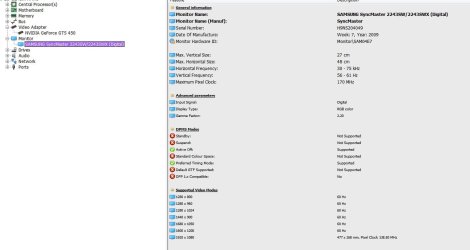

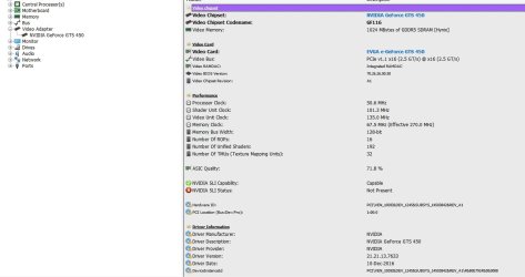

Here are the screenshots of the info from the GPU and monitor, I figure the info for the other components wouldn't be necessary. If it is the monitor, I'd probably go with 21 inches again, the current 21 inch display I have is big enough for me. The fun part is finding one that takes DVI when it comes to name brands, most of the Samsungs are VGA or HDMI, there's no HDMI port on my GPU, and the ASUS displays have DVI but speakers. How is Acer?

Ok mate now that was good that you now can use the HW Info to see what is in the machine eh?:)
Now yes a 21" is fine and really that sort of size you could pick up one for a song. The issue with inputs is annoying as I recently bought a Samsung only to find that it only had VGA (crazy move but) and HDMI which my main desky card supports.
