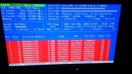

What I've done so far: I ran memtest86 for multiple hours. I got 57 errors, but all during test13 (hammertest), all others passed. By what I've read so far this shouldn't cause issues during normal use. Switched it with another stick from my second pc, didn't help though. Picutes of the result attached.

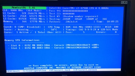

I ran memtest86+ twice, different results as you can see in the attachements. And I don't know if it has to do with hot ambient temperatures, but I'm at the point where my pc crashes after about 10 mins of bf4 and I normally can't even finish one game...
I might run it again when I have more than 10 hours time but atm that's the longest I can go since I still wanna use this machine. And because of the quite significant amount of crashes lately I decided to upload a more recent collection of the dump files.

If MemTest86+ has shown errors then there's a problem with either your RAM or the DIMM slot/s. Now it would be best to test each stick in each slot to see what fails.
If the output is like this then you have bad RAM so the stick(s) need replacing.
Test|Slot 1|Slot 2
RAM 1| Error | Error
RAM 2|Good|Good
If the output is like this then you should replace the motherboard, however you can leave that DIMM slot empty although it's not advised to use a system with a faulty motherboard.
Test|Slot 1|Slot 2
RAM 1| Error |Good
RAM 2| Error |Good

So quick update: For the memory test: I tested all slots with my two sticks, plus a third 8 gb stick of my second PC, a while ago but not testing it with memtest86 but just running intel burn test to see if it would freeze up, and no matter the combination it did.
But it seems as things have taken a turn for the better:
After over 3 months I FINALLY got my PSU, a Corsair AX1200i, back from RMA. I swapped it out for my AX760 which I ran to replace it and look at that: Crashes be (almost) gone. During the whole weekend with more than 15 hours of play time I only had one crash. Comparing that to the week before where I had over 15, near 20. I hope this isn't just a coincidence, but it seems too extreme a change to be one. But it makes me wonder if the 760 was insufficient under heavy load or if it's faulty...
Because in order to find the root of the issue I also tried running the system with only one GPU and no overclock on the CPU. With that setup I still had crashes but a 760 Watt PSU should by far be sufficient for 1 970 and an i7-4790k both running stock...
So I'll leave this thread open till next weekend, if I still have next to no crashes I'll mark it solved and blame my PSU even though that seriously surprises me...

When you switch out hardware, try loading defaults in BIOS. The old configuration may be interfering somehow.
Did you memtest with the new setup yet?

As stated in the original post: For the entire last year I was only home on weekends. But that will finally take an end by the end of this month. Then I'll have time testing the system. But just until now I didn't have time to run memtest86+ again. But I suppose I might have had multiple issues and that for now I was able to get rid of the most common. But I can't really see how my PSU would cause memtest errors so I will definitely get back to that...
edit: I loaded bios defaults more than once during the past 3 months. I even reinstalled windows twice trying to get rid of this problem.

So: As previously stated: after I changed my PSU back to my original that came back from RMA I didn't encounter any issues for the entire weekend, and that was amazing. But The crashes came back. But that post about loading default BIOS settings got me thinking, so I decided to check for a BIOS update. I did that when I first bought the mobo and got the newest one. But that was october 2013. So I headed over to ASUS and look at that: new Bios version from 2014, described as "Improves system stability". Yeah well it did. Ran Memtest 4 times, not a single error with 20 passes, ran prime np, furmark np, and played over 100 hours since. had a few games crash but never the entire PC like before. So yeah, learned something: Keep your BIOS up to date...
So thanks for the help, I'm just glad that all is working now and hopefully I don't need to edit this thread ever again:D
