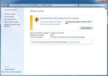

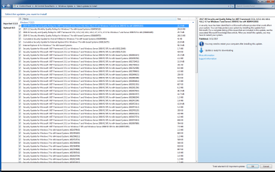

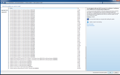

.... Windows Update still lists the same 115 Important Updates after running WSUSOffline!
Custom built desktop, last fresh W7 install at least 5 years ago - love this thing! Finally went for a SSD upgrade and decided for a fresh Windows 7 install.
After installation, Windows Updates had 115 Important updates. Overwhelming. Came to 7Forums for a list of "must-avoid" updates and in the researching process, I came across a post recommending WSUSOffline.

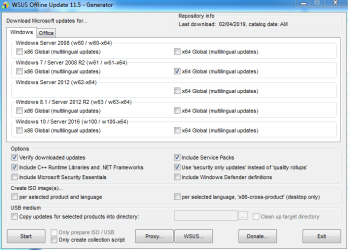

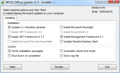

So I decided to try WSUSOffline. I went with the basic selection. It downloaded files for a while. I thought I was being hacked by Russians. Then I went for the install phase, also with the basic settings. No error messages and everything seemed to be fine. Let the machine do its thing overnight, as it took a while.
At the end of the process, after a few reboots, Windows Update still shows the same 115 needed updates. As if WSUSOffline didnt do anything.

WSUS Offline Settings:
