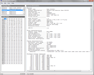

An addition: I took this screen grab of my monitor output via the program monitor asset manager. I'm wondering if I can glean anything off these. None of the options on the top left show native resolutions of 1600X1200 though. But a few are kind of goofy, the HWP1618 showing 1024X768 which may be a problem. I don't understand why there are so many monitor options though...should be only acer and pioneer correct?
