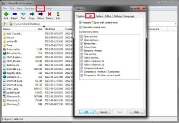

7-Zip has an option to set for this. To do so: :)
  • Use Run as administrator on 7-Zip
  • In 7-Zip, click on Tools (Menu bar) and Options.
  • In Options, click on the 7-Zip tab, uncheck the option(s) you do not want, and click on OK.

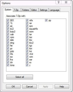

You could associate 7-Zip to be the default program to open that file extension (ex: .zip) to remove "Extract All..." for the built-in ZIP handler in Windows. You can do this in the same area above, but in the System tab instead.

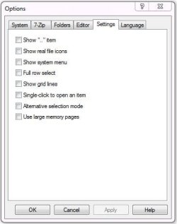

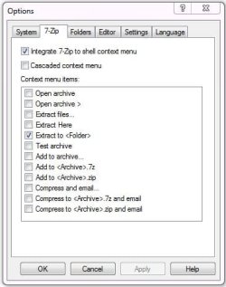

Unfortunately all the file associations under system are already checked and the reg file you provided did not solve the issue. Initially I tried deleting CompressedFolder\ShellEx\DropHandler since the item is only there after right click drag but that didn't help either. I attached a registry export of HKEY_CLASSES_ROOT\.zip, HKEY_CLASSES_ROOT\7-Zip.zip and HKEY_CLASSES_ROOT\CompressedFolder as well as screenshots of my 7-Zip settings to give a clear picture of what is going on. (Restored CompressedFolder to its original state after trying your modifications.)
