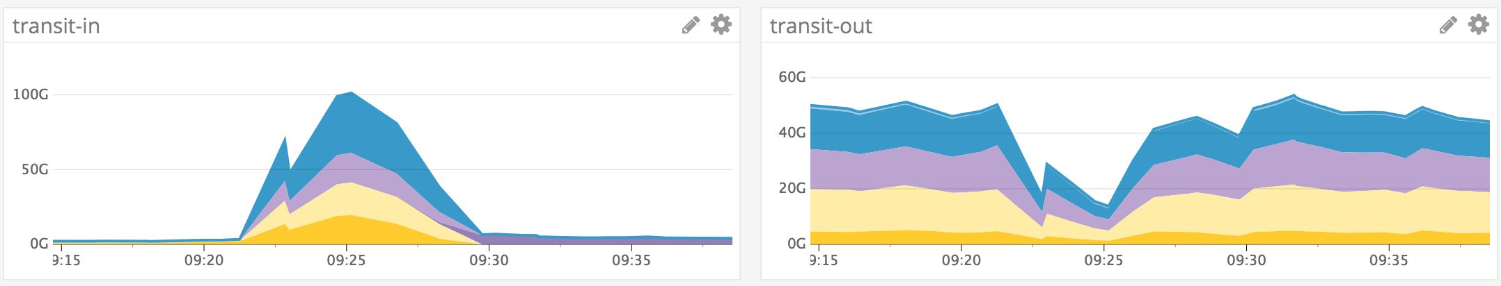

At 17:21 UTC our network monitoring system detected an anomaly in the ratio of ingress to egress traffic and notified the on-call engineer and others in our chat system. This graph shows inbound versus outbound throughput over transit links:

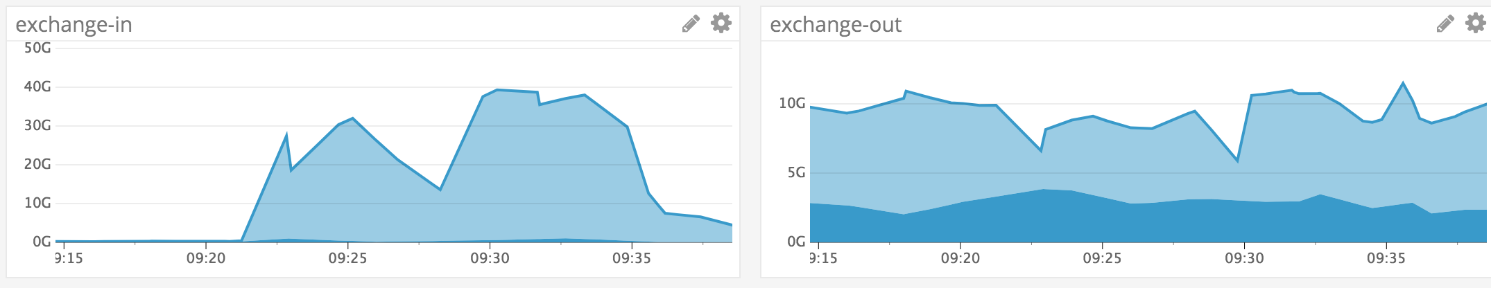

Given the increase in inbound transit bandwidth to over 100Gbps in one of our facilities, the decision was made to move traffic to Akamai, who could help provide additional edge network capacity. At 17:26 UTC the command was initiated via our ChatOps tooling to withdraw BGP announcements over transit providers and announce AS36459 exclusively over our links to Akamai. Routes reconverged in the next few minutes and access control lists mitigated the attack at their border. Monitoring of transit bandwidth levels and load balancer response codes indicated a full recovery at 17:30 UTC. At 17:34 UTC routes to internet exchanges were withdrawn as a follow-up to shift an additional 40Gbps away from our edge.

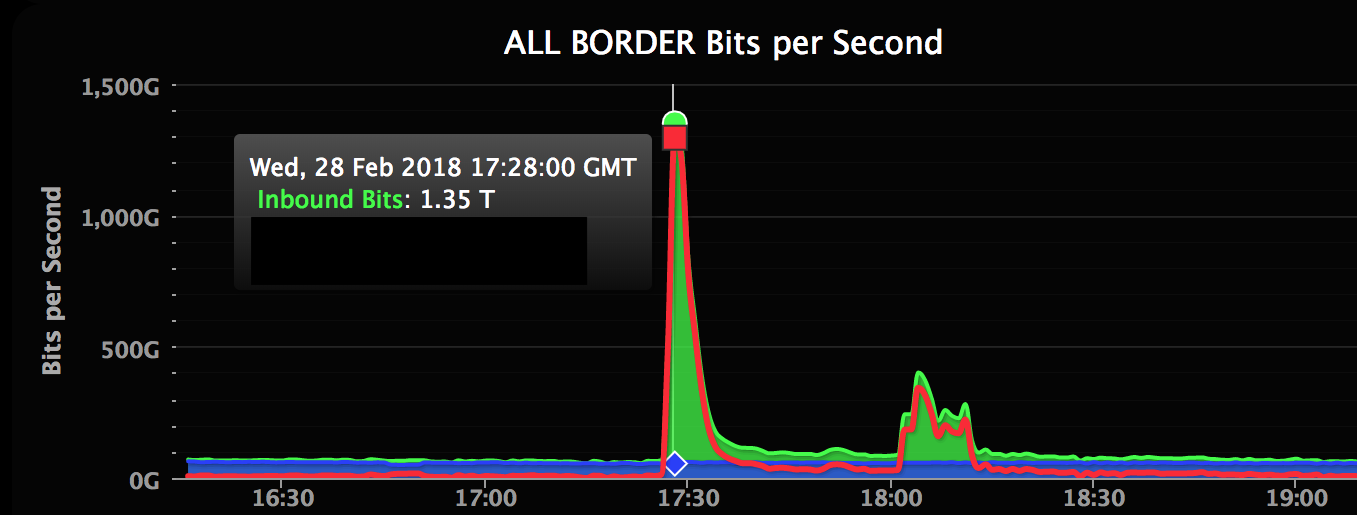

The first portion of the attack peaked at 1.35Tbps and there was a second 400Gbps spike a little after 18:00 UTC. This graph provided by Akamai shows inbound traffic in bits per second that reached their edge:
