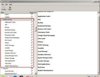

You can try Bleachbit:
Clean Your System and Free Disk Space | BleachBit
   Note
Not to be used for a full cleanup except by expert users as it will screw up your system.
Run it and configure preferences:
Exit the program and re-launch it.
Uncheck everything except the checkboxes for each installed browser:
Click the "Preview" button to scan and see the results (test clean without actually cleaning)
If you are happy with the results - go ahead and clean.

I did the BleachBit thing on all browsers.
I removed ffx and the data folder.
Reinstalled ffx.
I removed BitDefender.
Problem still exists.

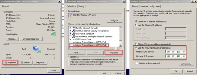

Also it won't hurt to try this:
Open Network & Sharing Center and double click your Network Adapter.
Apply seetings as in the screenshot but in the third image under "Use the following DNS Sever" use the following:
8.8.8.8
8.8.4.4
That's Google DNS. Make a note of your current settings first. Apply and reboot then test.
Settings were default / obtain auto.
No love.
