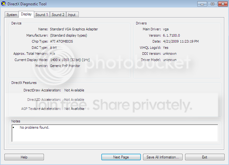

I'm tempted to say that it's not a driver issue, mainly because nothing is showing up at all, in anything. One driver installation failed because it couldn't find the card. Here is a shot of the problem.
A perfectly good ATI driver for the X1400 was removed from Windows 7 some weeks ago. I used a Vista driver and it's fine. I had to force the driver to install by directly specifying it in spite of Windows 7 saying it's not compatible. I was disappointed they removed the support for older ATI chips.
