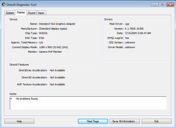

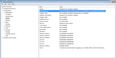

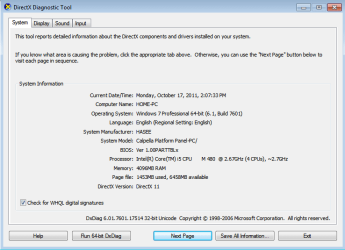

This thread is quite old but very much similar to my problem. I have a Hasee M215 panel PC with GT330M graphics card. GPU-Z shows it as GT216. The manufacturer website gives a 32-bit driver but I have 64-bit. Is there any solution to this problem?
Windows 7 Professional x64Intel Core i54 GB DDR3
Intel Core i5
4 GB DDR3
Manufacturer Website
I have already tried both the latest driver and the Beta Driver but the installer says-
"The Graphics Driver could not find compatible Graphics hardware."

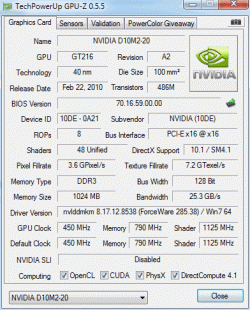

Thanks a ton! The modded inf did the trick! I'm really very grateful for your assistance.:D
