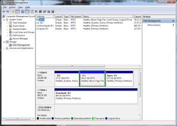

I just did. Restored to a couple days back. HDD ( E Drive ) still goes missing after a few minutes if i use it (it's my storage drive where i keep videos, photos, music, etc).
I tried using HDD Regenerator and after a while, it didn't find any bad sectors or errors.
Also, i tried chkdsk e: but it kept on showing "Errors found. CHKDSK cannot continue in read-only mode". :mad:

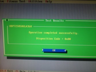

I just did the hitachi test thingy.
There are 2 options. Quick test and Advanced.
I first did the quick test and the result came back with "Operation Completed Successfully. Disposition Code : 0x00".
I then proceeded to do the advance test and about 10 minutes in, the drive gave 1 clicking sound and died again. I had to remove the drive cable and re-insert them before it works. But i did not continue the test as i thought it could die off again.
No idea if the drive is failing or it could just be the cable. :S

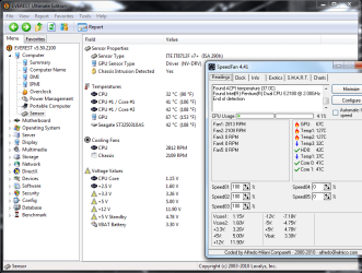

@Karl
Attached is Speedfan. Is there something i should be worried about looking by the image?

Is Temp1/Temp2 on Speedfan the same as CPU #1/CPU #2 on Everest?
If it is, then something is not right cause they don't show the same temperature.
Edit : Looks like i made a mistake. They both do tally. Though i have no idea what Temp1 and Temp2 is. :S

The bottom Temp1 37C is your CPU.
Core0 and Core1 are actual in the chip at 40C. That is good.
If Temp1 on top at 127C was your CPU it would have already died.
I'm not sure what it is showing though on the top Temp1 and 2.

the 127C are references to a sensore that does not exist.
Nothing to worry about.
If anything was truly running that hot, you certainly know by now.

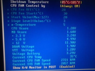

1) What event to you have in the event log in reference to the disc.
Sounds as if the drive is dying, but as mentioned it could be a connection issue.
If in events its showing Controller errors, then its a very likely possibility.
2) In your bios, what do the voltages say? Its possible Speed fan is giving some false/out of whack readings. Might be worth verifying what the bios has to say.

1. Sorry but i'm not clear on where exactly do i get that information. Could you please elaborate.
2. Please view attachment. :)
Sorry about the quality. I took it with my cell phone.

That all looks normal actually.
Although, the 12V Rail does look a little bit low at 11.90V.
Rather see it just a hair over 12V.
Although, I'm not sure if that would cause much of an issue though honestly, as it is close to where it should be.
Sometime SpeedFan can give odd results, depending on the HW. Was just curious what your bios were reporting.

Then i guess it's got to do with the Hard Disk itself (maybe not, i'm not a professional :P ). My other (primary) hard disk is working fine (i'm on it now).
Only the secondary drive (hitachi) kept disappearing every few minutes.
I just called Hitachi and i'll probably get it replaced since my warranty is good till December 2011.

Is this a prebuilt like HP or Dell or a custom?
The reason I ask is to find out if it has a stock OEM power supply or an aftermarket brand you installed.
Power supply isn't listed in your specs.
If it is an OEM PS then that would account for the 11.9v with the three HD's etc. you are running.
As Wishmaster stated looks normal.
Hope you get a new HD replacement.

It's custom. Not built by me but it's custom for certain. :)

That should be sufficient with what you have running from my perspective.
I was afraid you had a little 250W or 300W in there. :D

Is it really? Well, i guess i should be all set. Just got to deal with the HDD issue now. Not fun to deal with this early in the morning. :confused:
