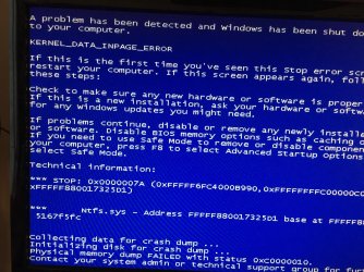

It may be too late for that. Woke up this AM, and had the following: Restarted, and the monitor just kept flicking, no loading.Tried another restart, with a different monitor, and got the opening Gateway Logo, then nothing, just stopped working. I assume that this is due to a complete HD crash.

Bummer. You may still be able to recover the image to a new hdd. Use the Gateway discs to restore the system back to factory, then install Reflect, create the Rescue Media, then boot from the Rescue Media and restore your image.
