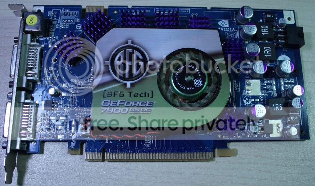

I used a BFG-Tech Nvidia Ge-force 7900 GS OC,
And a Zalman VF-900-Cu Air Cooler.
The Steps I lay out here are more or less interchangeable, And apply to a lot of different cards and setups.
About the Card used:
BFG-Tech Nvidia GeForce 7900 GS OC 256Mb

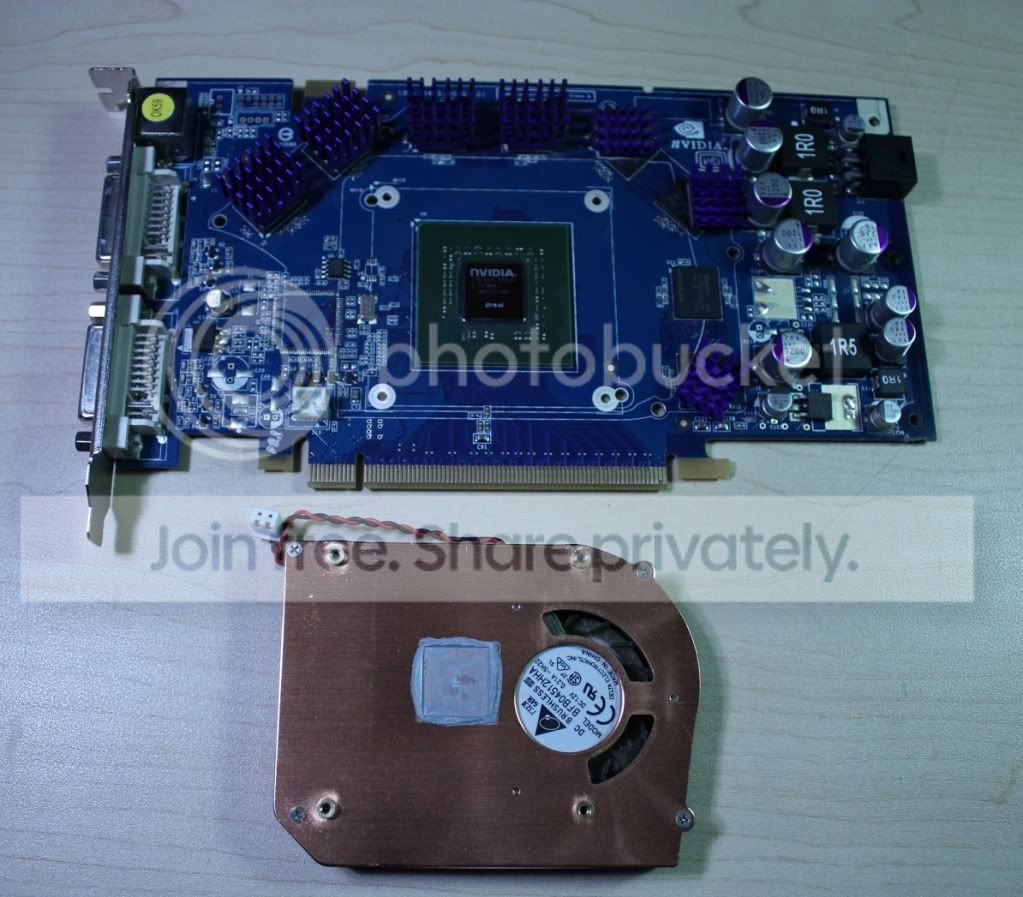

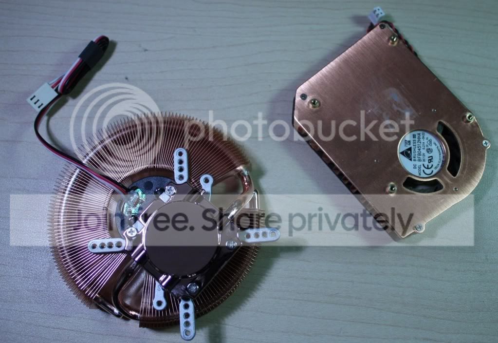

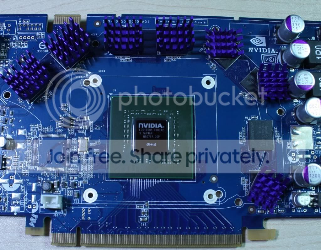

On the Back of the VGA card, Remove the 4 3mm Philips screws from the stock fan and heat sink assembly.
There Really is a Pretty big difference on the size, quality and gauge of copper used here.
Old Vs. New Sink and Fan.
Step 2:

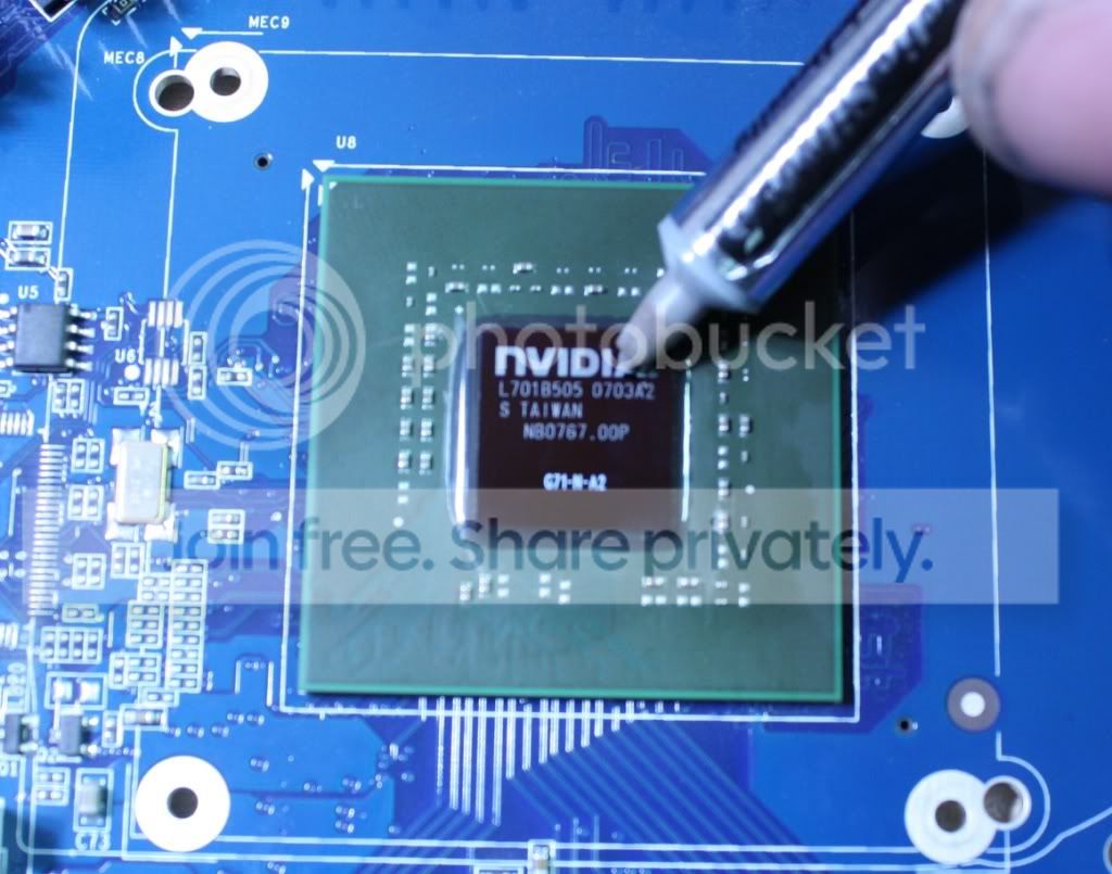

Clean the GPU surface REALLY WELL with a damp rag moist with Technicians grade Isoprophol Alcohol, and make sure the contact surface of the new cooler is also extremely clean.
Step 3:

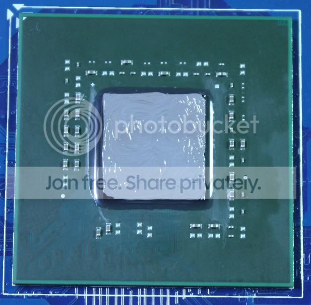

ADDING THERMAL COMPOUND:
Use a Very SMALL AMOUNT of Thermal grease on the chips surface to Help bond the the Sink.
If you use too much, It'll act as an insulator, keeping heat in, and negating the primary purpose of having the grease in the first place.
Thermal Grease does a few different things:
1. It helps Create a much more efficient thermal transfer between the chip and the copper sink.
2. It helps bond the sink to the chip as to not let it shift, or rock loose in the event of a nut or screw loosening, *still* helping the Thermal Transfer to be more efficient.
3. It acts as a vibration damper from the fan, and other moving components around the chip and other parts on the PCB as to not cause any unnecessary wear or possible solder-joint breakage or separation due to fatigue related stress and mechanical component vibration.
Also, I ONLY use Artic Silver 5 or equivalent, because of the metallic base. I believe that It's a lot better than ceramic, because it has a much lower heat capacaty, and Ceramic as far as I've ever learned since I was a young kid, is used as an insulator... Am I missing something? I do know that metallic over ceramic thermal compounds are good for an additional couple of degrees in cooling when doing an upgrade like this one...
Remember: If it makes noise, it vibrates. and Chips don't like being jarred around.
This is Actually more than I wanted to put on, and I went back and scraped about 10 or 20% of it off, and smoothed it with a razor blade so It'd look pretty before i smashed a Copper Heat Sink on to it. :cool:

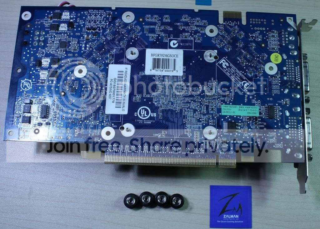

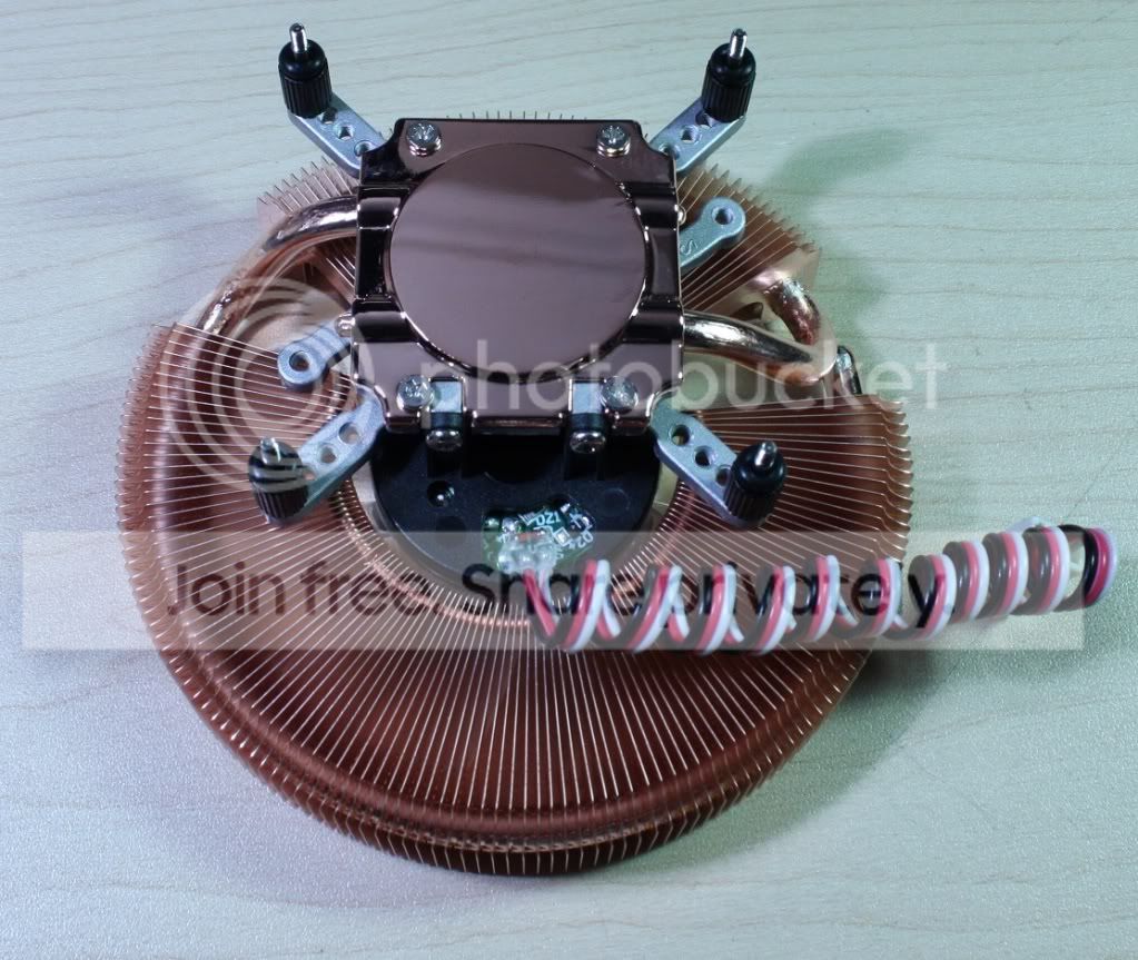

Check your Documentation to see which holes you need to place the new mount posts onto, and snug them in to place.
Then, Make sure you add the 4 Rubber Washers on the mount posts at this point, as they'll help with Vibration-Damping the fan once mounted, and also help prevent PCB Damage due to Accidental over-tightening.

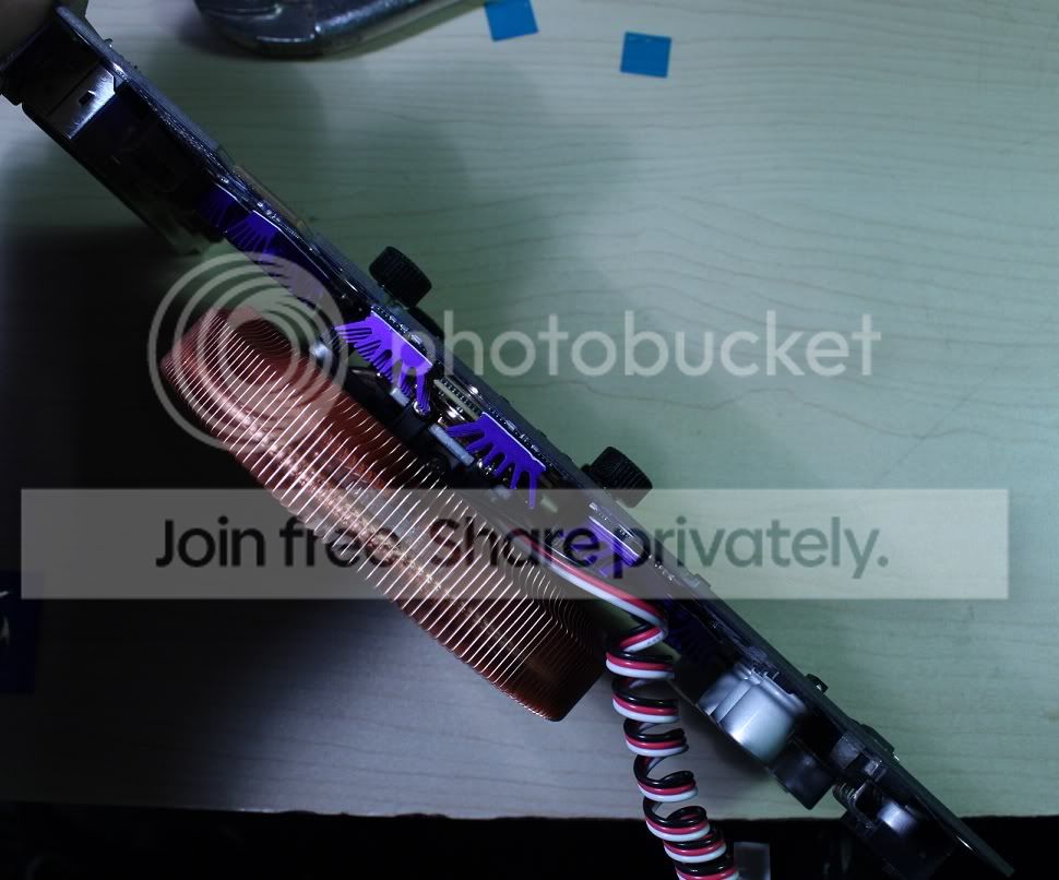

I Like to coil all of my fan wires around a screwdriver or something similar to give it that spring look. It's pretty, it keeps the case neat, and doesn't cause additional stress to the wiring, like a zip tie or stuffing it under a mainboard can do.
At this point i noticed that the Solder joints are exposed on the fan motor wiring, and the solder job didn't exactly look amazing, but I was careful about moving the wire around a lot and later on went back and put a drop of electrical grade clear silicone-RTV over the Exposed solder joints to prevent a shorting out in the case of a dropped screw or something of the sort, and to act as a stress reliever on the wire itself.
Step 5.
Assemble the Nut assemblies by pressing the springs onto the Black Plastic coated nuts. I don't know why they didn't either manufacture the nuts with springs already included on them, or attach them in the factory, but this seemed odd, was a little difficult to do in relation to the rest of the project, and was annoying to have to locate the pieces and put them together, considering the rest of the project is pretty simple.
Step 6.

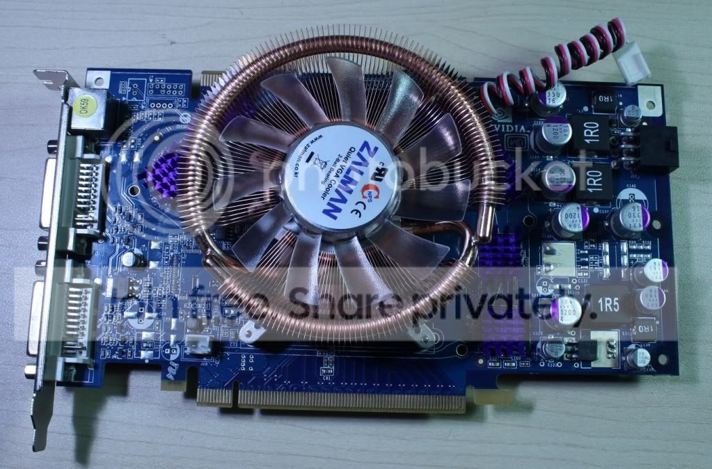

Lay the sink/fan faced down and set the card on it, aligning the holes as you set it down, Give it a *little* jitter back and forth when you do to seat the GPU in the thermal grease correctly and ensure no air is trapped in the Grease. Next snip off the plastic washers from the parts tree they come attached to using flush-cut Wire dikes, (or really just twisting them off is fine too... but My OCD made me want them to be aesthetically perfect.) and add them to the posts after setting the card on the sink/fan assembly. at this point It's a good idea to go ahead and attach the anodized aluminium heat spreaders on the RAM chips on the board.
Step 7.
Holding the card Steady with one hand, spin the nuts on one at a time, in an alternating Pattern, and DON'T snug them until you have both/all 4 nuts (depending on your card type) on their posts. Snug the nuts just a bit past finger tight, and you are done!
Step 8.
Either use the included speed speed control to rig the fan or plug the fan into an available ATX+12vDC 3 wire fan port on the mainboard, install the card, plug in your ATX 12v Power, and go for it! The Fan itself really isn't a lot thicker than the stock fan, and I didn't have to reconfigure anything when it came time to install the card in my rig.

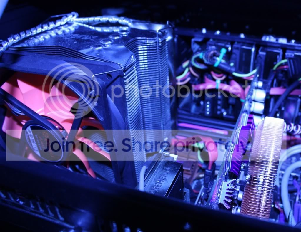

The New Temps are MUCH lower now, dropping from between 60º to 70º Celsius down to around 44º to 46º Celsius thanks to the new upgraded *properly working* heat sink and Fan, and It's much quieter than the stock fan was, even when it was working properly.
One thing I didn't like is the damn blue LED lights. I didn't bother cutting the LEDs like i Usually do, although it did cross my mind. I don't even plug my Power and HDD Activity
LEDs in on the front of my case, To me, It's just not Necessary, or desired.
