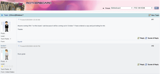

@stevenfr - Your mobo will support Windows 7 just fine. There is a conflict in the screen resolution presented to the TV (which acts as a monitor secondary to its primary design function).
Windows 7 uses the hardware differently than earlier versions - notice the fundamental change in the boot screen. You might try /noguiboot in msconfig.
I do not have a solution for you. I just needed to correct kegobeer's misinterpretation of no Windows 7 driver support at Asus. I have a P5 class board and no problems - but I also have a TV/monitor designed for this use. If you must use Asus provided drivers, get the Vista 64 ones.

Let me clarify - Asus does not list the P5E-VM in the Windows 7 OS compatibility section of its website.
ASUSTeK Computer Inc.
There are no Windows 7 drivers available for the motherboard, which in of itself is not surprising - quite a few motherboard manufacturers don't have Windows 7 drivers available yet. However, if Linux installs via HDMI, and Vista installs via HDMI (unknown - the OP didn't state if that has been attempted), but Windows 7 does not, there is a compatibility issue that can't be solved at this time, unless a no gui option exists that may bypass the issue. Asus may release a BIOS update that fixes the problem, but I suspect that may not happen, as that motherboard isn't listed as having Windows 7 logo certification.
