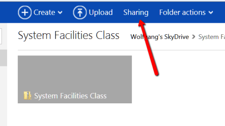

1. The Macrium I use is the free product. The WinPE .iso I uploaded is from that freeware.
2. I use Skydrive since many years. You have to sign into it to establish an account, but there were never any problems.
Two tips:
1. In Skydrive you first define a folder and give it a name, then you load your data into that folder. The advantage is that the folder address stays the same and you can update the content many times (delete the old and upload the new).
2. Making the public is a bit finagle. But per default it is not and you have to go to the 'Sharing tab' above and then 'Get a link' - see pictures.
