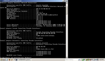

ok here is the ipconfig of the eeepc with xp on it. The dns flush didn't do anything, but I did get an error message about how it was not able to connect to the dhcp server or something like that.
