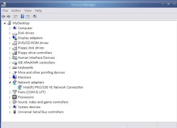

Firstly are you connecting via the the Ethernet or by WiFi? Please open the Device Manager (Control Panel\All Control Panel Items and then Click on Device Manager). If you can then please upload its screen-shot but if you cannot do it then please inform how many unknown/uninstalled devices do you see there. The Devices that are not installed would have a yellow background exclamation mark or may be a question mark and they shall be open. Please see a screen-shot of my Device Manager.
As you can see all my devices are spot-on but I have opened the Network Adapter for you to see. Please particularly advise the status of any Network Adapters. If the Network Adapters are not installed then we shall first try to install from the Installation DVD, otherwise we shall connect to the Net and download it from the Samsung Website.

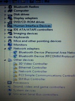

Ok I try to take a shot with my iPhone and upload it . And I'm using wifi , but my computer can't detect any Internet at all and trouble shooting can't find any problem!

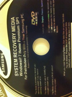

I have only one cd from Samsung , I have a samsung 300v5a, and the cd seems only carry system recovery media but no drivers !

I tried to update driver sofeware but I can't connect to my Internet and have no driver in my computer , and I'm not sure if I disk has the driver files since it says it's only a recovery disk! And I did it by the stupid way to search the driver files from disk e( I put the recovery disk in) and it says it can't find any driver from the disk !! This is how my disk look like!
