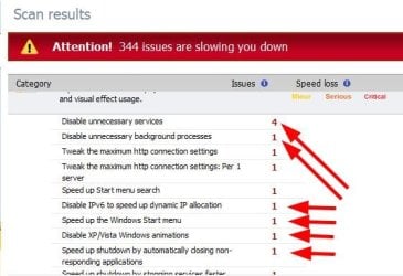

I just looked at SpeedUpMyPC and I don't trust it at all. For instance, this is what it said I should do on my computer:
It doesn't say what services or background tasks. My system is pretty lean already and I run only the services and processes I want. Allowing it to fix these would probably screw up my system seriously.
This is UniBlue- right?
I can't remember why, but the name UniBlue leaves a knot in my stomach...
IMO, Stay away from 3rd party tweak software, You can make all same changes manually if that important. Manually will force you to learn what your doing and how to return it if bad.
