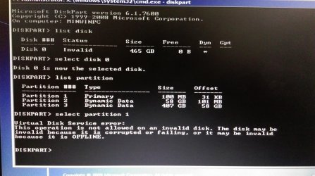

I tried the first step which was selecting the partituon and marking it active. But it failed i guess.
I have attached the screen shoot. Under list partition it shows 3 partition. Partition 1 i am not sure about. Partition 2 seems to be my c drive ,where windows was installed. And partition 3 seems to be my d,e, and f drive combined. How that happened, i have no idea. I used to have 4 diff partition. And a 20 gb partition wch i made few days back for linux.

I have posted the screen shot with this, of diskpart where it dint go through.

Obviously you have a failing disk so you cannot now mark the 100mb System Reserved Active and run Startup Repairs to recover from the Linux disaster.
What to do now is to test the hard drive with the maker's HD Diagnostic
extended CD scan followed by a full Disk Check to find out its exact condition and possibly replace it.
If it passes diagnostics, then you can attempt to rescue your data at any time by booting into the WIn7 disk to browse for it using Copy & Paste - in Windows Recovery Console. Not seeing any data will strongly suggest its ruined.
If you can get the data then I'd wipe the drive with Diskpart Clean Command then try a full disk partition format following the commands to create, full format and mark Active in Step 2.2 of SSD - HDD Optimize for Windows Reinstallation. If it then passes Disk Check you can reinstall to the partition you created.
