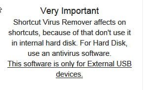

Shortcut Virus Remover only works on the USB devices. It does not remove the root cause that is hidden on your PC's system drive. So one also needs to cleanse the PC to get rid of the virus to prevent the USB devices getting infected repeatedly. You might have failed to read the following in the Shortcut Virus Remover link you had given.
USBFix is currently recognised as the complete antidote for annihilating the Shortcut virus, cleaning both the internal HDD and the USB device/s.
From the author's mouth: ( English is not the native language of the author of USBFix.)
"He doesn’t content with cleaning your USB keys, cards SDs …
He will also clean your PC if the infection is active on the system.
He clean the famous ” shortcut virus USB “.."
