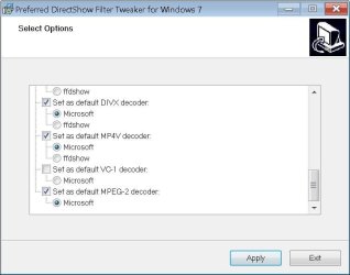

There is solution.
First ur gonna install MPCVideoDec.ax from here. Unpack files and copy decoder to system32 folder. Then Start>>cmd and run it as administrator. In command line paste bolded text ...\system32\regsvr32 MPCVideoDec.ax then press enter.
Now download this tool and choose that filter as VC-1 decoder. And ur done!
Additionaly u may check properties of decoder as it decodes many formats as default. If u want only VC-1 u have to uncheck the rest of formats.

There is solution.

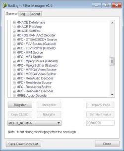

I actually tried those exact steps and it didn't work. Even though I registered MPCVideoDec I am not sure my PC was registering it properly. Using Filter Manager under Direct Show Filters MPC - Video Decoder does not show up (running Vista it would show up after registering).

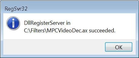

Yeah, I used the MPCVideoDec x64 filter. After I register the filter a popup shows saying something like "DLL service has registered successfully...". It is very weird because I am doing nothing different then in the past on my Vista machines. All those machines will show MPC Video Dec in the Filter Manager. It does not show up in the filter manager for W7, so I assume this has to mean it is not getting registered properly. I will see if I can tinker around with it tonight
W& x64 RC1
W& x64 RC1
I have attached screenshots showing that I was able to successfully register the x64 MPCVideoDec.ax file, yet it shows up nowhere in the filter manager or in the W&FIlterTweaker

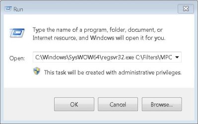

Yes its really strange. You registered filter and programs cant see it. I have never had 64bit win so that would be my guesses. First copy decoder file (*.ax) to folder where are stored other direct show filters (on 32 bit os its system32), and register it there. Secondly im not sure if radlight can detect 64 bit filters since it is 32bit application. Or maybe there is 64b one actually?
Another thought would be that You have to download the very last version of tool (that w7 filter manager i pointed u) because MPCdecoder was added just very recently. I hope ur problem can be solved.
