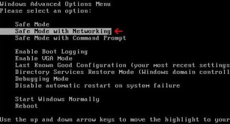

Start in safemode with networking and scan for malware. To do so you need to
Press and hold the F8 key as your computer restarts.Please keep in mind that you need to press the F8 key before the Windows start-up logo appears.
Note: With some computers, if you press and hold a key as the computer is booting you will get a stuck key message. If this occurs, instead of pressing and holding the “F8 key”, tap the “F8 key” continuously until you get the Advanced Boot Options screen.
On the Advanced Boot Options screen, use the arrow keys to highlight Safe Mode with Networking , and then press ENTER.

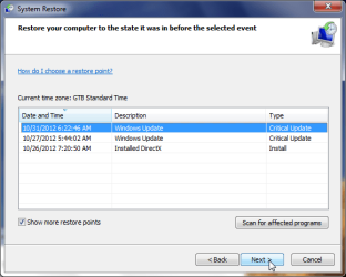

If your computer has started in Safe Mode with Networking, you’ll need to perform a system scan with Malwarebytes Anti-Malware and HitmanPro ( update these programs before you scan, in the safemode with networking )to remove the malicious files from your machine. If does not work, you can try reverting your machine to a previous state using the system restore utility. Once restored, go into safemode again with networking and repeat step 1.

When did you get infected? Do you have "restore points" prior to it? You know exactly which folders have ben encrypted?

my system dont have restore point please help me

Why did you disable that feature? If they had been made you could go back in time using option "previous version of folders and files". http://www.sevenforums.com/tutorials/85679-previous-versions-restore-files-folders.html
