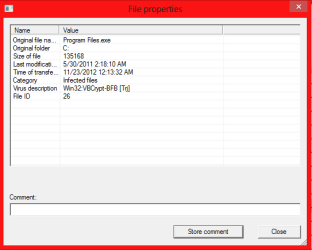

I inserted my USB onto my PC .
and when I moved files to my PC it's size became 132KB and converted into an .exe file
I tried to open it and my antivirus detected it to be a Trojan Horse (Win32:VBCrypt-BFB [Trj] - Virus description of avast!
so I turned off my antivirus and restored the folder (thinking my precious files would be deleted) .
and everytime I open it , it opens in a new window and an error pops up .
and I turned my antivirus on again and I deleted the exe folders
now I know that it is made by virus and this virus is hiding my folders
I don't know how to reveal it
PS : All my files are accesible through address bar , but I want to open it via double click so please pay attention to my post and help me ( I'am a newbie here and this is my 1st post on forums like this )

First off, start by trying to do a system restore, not to the 1st point of infection, but 2 or 3 points back. (Viruses generally embed themselves in the 1st restore point). This may solve the problem although a full system AV scan is recommended even if this seems to solve the problem.
If this does not yield results, try running Windows Defender Offline. Be sure you d/l this on a clean computer, not on the infected one.
http://www.sevenforums.com/tutorials/166445-windows-defender-offline.html?filter
Another option is Norton Power Eraser...be sure to read the doccumentation.
Norton Power Eraser | Free Tool |Easily remove scamware that traditional virus scanning can
Because Norton Power Eraser uses aggressive methods to detect threats, there is a risk that it can select some legitimate programs for removal. You should use this tool very carefully. If you accidently remove a legitimate program, you can run Norton Power Eraser to review past repair sessions and undo them.
Another good program is Malwarebytes. The free version will work well.
http://www.malwarebytes.org/products/malwarebytes_free/
This is listed as a backdoor Trojan, so if you have done any online banking or logged into any site, it may be a good idea to change your passwords on a clean PC.

OK I have 3 partitions .
what I did on my 1st partition ( which is windows 7 os ) - I did a system restore
on my 2nd I reformatted it
and on my 3rd ( Windows 8) - I refreshed it
But before I do all of these , I followed what you said
I did a full system scan using my AV and malwarebytes and deleted all detected threats .
