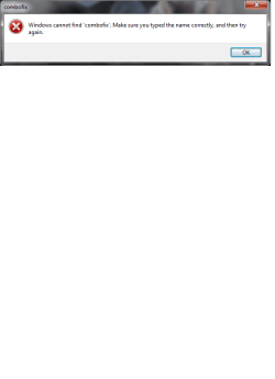

You will need to uninstall Combofix now.
Click on the Start button and then select Run from the menu. This will open up the Run box.
Copy/Paste combofix /uninstall (Please note that there is a space between combofix and /uninstall), click on the OK button or Enter on your keyboard.
You can now delete the ComboFix.exe program from your computer

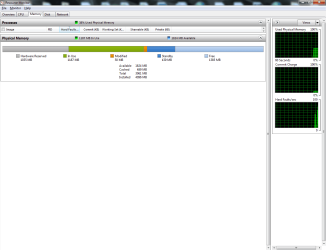

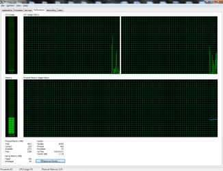

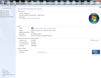

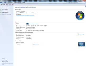

Sorry to have to ask for more help.
I may not have de-installed the Software that we used to disinfect my System PROPERLY.
I say “may not have” because I do not remember; I’m 68 and loosing it quickly, "memory / pun".
The symptom I see is: 1 GB of Memory is not available for Windows-7 to use.
I have used the Hardware Form to insure it’s not a Hardware failure to include replacing the Memory.
If you will, please tell me how to de-install what we installed one more time.
If you can, perhaps consider what would cause 1GB of 4 GB’s to be “unavailable”.
I will include several Screen Shots.
Thanks again for your help and understanding.
Best regards,
Mike Lynch

Off the subject:
Looking at your resource monitor, I had a look at mine and I got 1 meg of Hardware Reserved memory and you have 1035 megs. Thats 1/4 of your physcial memory and probably bogging you down.
I would look into whats taking up that much memory.

Did you uninstall Combofix as instructed above?
Please scroll down in this link ComboFix: A guide and tutorial on using ComboFix
To uninstall ComboFix from Windows Vista or Windows 7 please perform the following steps:
Now, reboot/ restart your computer.
Windows 7 Ultimate 32bit SP1
INTEL/D975XBX2
ATI Radeon HD 2600 Pro
Samsung SyncMaster 914v
1280 x 1024
One is not connected
Rocketfish 700 W
G.Skill Gigabyte Chassis
Standard PS/2 Keyboard
Microsoft PS/2 Mouse
DSL
Avira Internet Security
IE 11
ATI HDMI Audio
It appears like I had removed Combo, perhaps it's one of the other two?
