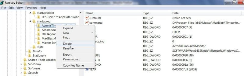

Hi Guys!
I used to use a tool to clean up unused items from the MSCONFIG window, but it will not work on Win7 64bit.
Is there a way to remove the items I have unchecked form my msconfig start-up tab area?
Thank you in advance for any tips!

You will find the entries under :
HKEY_LOCAL_MACHINE\SOFTWARE\Microsoft\Shared Tools\MSConfig\startupreg
HKEY_LOCAL_MACHINE\SOFTWARE\Microsoft\Shared Tools\MSConfig\startupfolder
Delete the ones that are not needed.
It means using Regedit, if you are familiar with that. If not - better leave it alone, or at least make a restore point before attempting anything.

Thank you , SIW2, Brink and Uber Philf!
