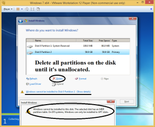

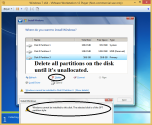

How to convert disk from MBR to GPT or GPT to MBR if you do not want to keep the existing partition style.
Convert MBR to GPT:
1. Boot from the Windows 7/8/10 USB/DVD in UEFI mode.
2. Delete all partitions on the disk until it's unallocated.
Convert GPT to MBR:
1. Boot from the Windows 7/8/10 USB/DVD in Legacy BIOS mode.

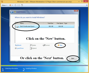

Installing to the unallocated space and letting Windows create the partition table and partitions works with either Legacy BIOS or UEFI boot mode.
On an MBR disk, Windows 7/8/10 setup will create a System Reserved partition and a primary Windows partition.
On a GPT disk, Windows 7/8/10 setup will create a Recovery partition (not in Windows 7), an EFI System partition, a Microsoft Reserved partition (won't show in Disk Management), and a primary Windows partition.
