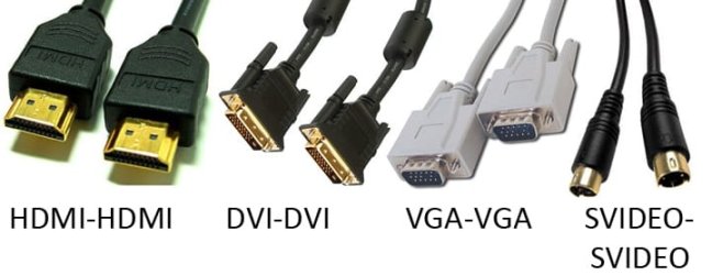

Here's an image to help ID what type of cable and connection you have. If possible, using HDMI or DVI would give you the best image quality.

Are you able to use a HDMI (preferred) or DVI connection with both the monitor and card as a test to see how it works with it?
Sorry the connection is VGA as i just looked on the back of the monitor and it is not going into the DVI in spot. There are no places for HDMI. Dont believe i fully understand your question. How do i test this other then just plugging the monitor into the desktop? I have to apologize for my lack of computer skills.

I had just meant to use a HDMI cable instead of a VGA cable to connect the monitor to the card with. That's all.

If it keeps happening, keep trying the "Detect" button, but you might also try using a different cable like HDMI.
