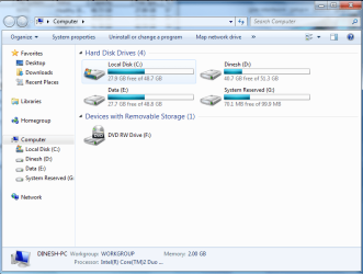

the system reserved partition was hidden last night. How do i hide it again?

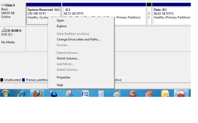

When i right click the system reserved partition in diskmgmt, i don't see any option to hide it.

I can't remember exactly what I did... (I did that on my friend's new desktop, I already had partitioned HDD) Try with Shrink Volume...
didn't work:(

Try this:
Go to change drive letter... and then remove or change (some option here)...
Edit:
I think that is the thing...

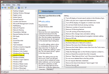

Here's how to hide a drive using Group Policy Editor:
  • Click Start, type gpedit.msc to search field, press enter
  • Find and open User Configuration > Administrative Templates> Windows Components > WindowsExplorer
  • Double click Hide these specified drives in My Computer
  • Choose Enabled
  • Pick the option you want
  • Click OK

Hello Kari, the option to hide the 100 mb system reserved partition is not there in the list.

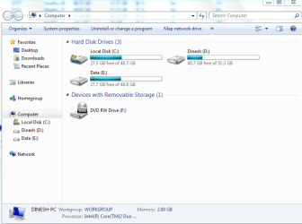

Hi Sassa, it worked. Thanks +rep.
Samsung NP530U4B-S02IN
Windows® 8 Pro (64-bit)
Samsung Electronics
1366x768
sucks
Google Chrome (Sync enabled)
What options you get? Could you change the drive letters so you 100 meg partition is one of those you can hide?

You could also do it by editing registry. Goto HKEY_CURRENT_USER >
Software\Microsoft\Windows\CurrentVersion\Policies\Explorer > NoDrives
Change REG_DWORD value. Values for the drives are:
  • A = 1
  • B = 2
  • C = 4
  • D = 8
  • E = 16
  • F = 32
  • G = 64
  • H = 128
  • etc., always double the last
To hide several drives, add values together: for example value 40 hides drives D and F
Kari
EDIT: Nice it worked. I've always done it with editing Group Policies or Registry.
