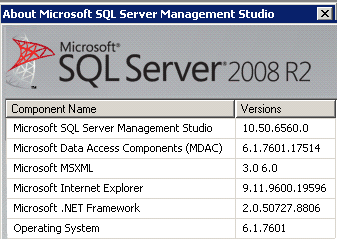

  • This is working with Sql Server version 2008 R2. This is not a production server. And I am running SQL Server Management Studio to debug a stored procedure.Here are the other versions of software that might be helpful:dtrwhu4y2axnms3w5lvemj1q0byz1z42.pngHow is remote debugging allowed on Microsoft SQL Management studio?This question might be misunderstood. I am not sitting at the computer where Microsoft SQL Management studio resides and I am attempting to debug a remote database. That is not the issue I am having at all. Instead, I have remoted into a client's server by their request and also I am trying to debug an issue they are having. You see, this is how things are evolving in our world. More and more there are situations where a developer is working from home and has to remote into a client's system do get some work done.When I open up their studio software on their side, if I try to debug or execute a command, I get this error message:5kprj.pngI want to be able to instruct them, on their side, what they need to do to make this problem go away. Please advise.This link is of interest:Enable remote debug t-sql in sqlserver

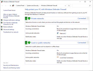

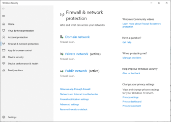

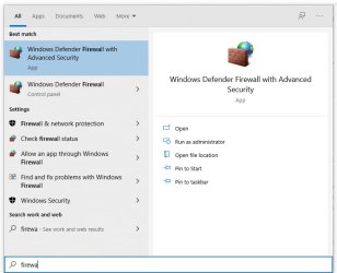

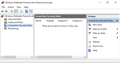

    So, I gather from this is that perhaps it is up to me to add to the Windows Firewall exception list:"The Visual Studio program, Devenv.exe" and "TCP port 135" albeit I am not running Visual Studio. But I am assuming it can't hurt if I do this.So, the question is: How do I do this?I am not experienced with working with firewalls. I do not know how to add firewall exceptions. When I look for applicable system programs, a number of them seem available. Can anyone guide me?38131f99a459ab056c639b746e0ba2e23cd6ae7f.jpega5c623bbac6654f473a39d59c30bb7835ff7ae43.png9148998517779a4b909b680992e0d063d4a0d801.png7109ccf57e311009718279595f6b4ae7d2eaf38d.png
