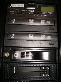

I have both 3.5" and 2.5" hot swap bays for just these situations, they come in very handy.

Yep my HAF has two at front too I agree very handy for this. But depends on OP's case eh?
