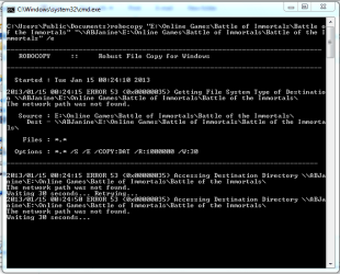

There's and error...

if you go to a explorer and and go to
\\ABJanine\E:\Online Games\Battle of Immortals\Battle of the Immortals
do you get a permission denied error.
or can you even access \\ABJanine

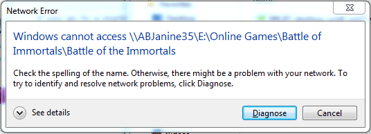

i got this error...

did you go into the \\ABJanine35 PC and share the folder? Is the location might be "\\ABJanine35\Battle of Immortals"
Sorry i had a brain fart about that.
