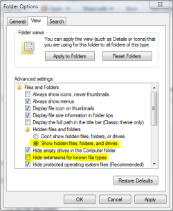

  2. Open Folder Options, choose Show hidden files, folders and drives. Uncheck Hide extensions for known file types

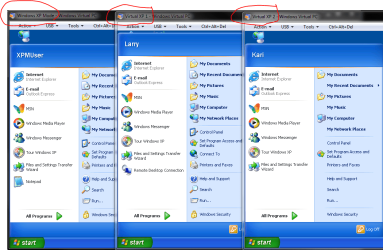

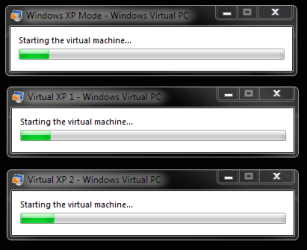

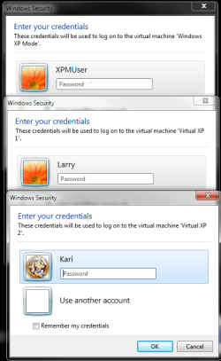

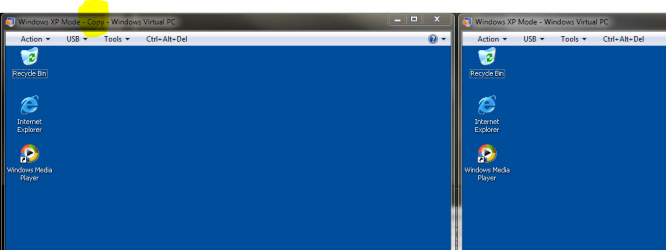

Yes. I have currently 3 separate, individual Virtual XP's for test purposes. Come back if you have any problems.
Three separate Virtual XP's starting, same time on same computer:
Three different users logging each on own XP:
Three XP's running:

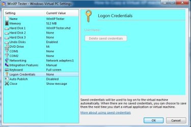

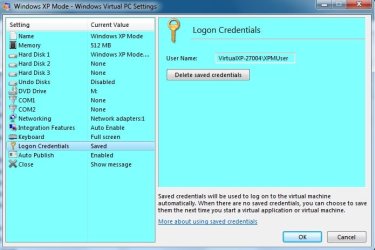

I've read the tutorial also, and your instructions are very clear. I've gotten a second copy to work, but as you can see from the screenshots on the settings I uploaded here, there's no separate login credentials like you've got for your three examples. In the second copy (WinXP Tester), Login Credentials is listed as "None" and the right pane is greyed out. How do you fix that? Thanks!

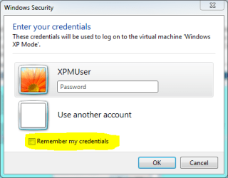

OK, now I understand what you mean.
That greyed out thing means just that for that XP machine, no logon credentials are saved. Next time you log on to that machine you have to give a valid user account name with password. If you want to, you can choose to save credentials (see the image).
If you click Delete saved credentials on the other machine (your image left), also that is going to be greyed out and next time you have to give the username and password. At the moment credentials are saved on that machine so login don't ask the password.
Hope this helps you.
