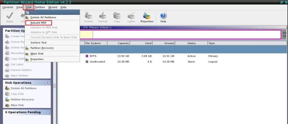

Alternatively, you can download Partition Wizard Bootable CD , burn in a blank CD, insert the newly written CD in the DVD drive, and power off your computer.
Now Power on .... press and hold F2 (as you are saying that your boot options key is F2; you haven't provided your motherboard info or brand in your system specs :confused:) to go to the boot options, select the DVD drive using the scroll arrow keys, hit enter to boot from the CD .
Let the CD to boot ... when prompted, select 1 for resolutions ... and you will be in the Partition Wizard's GUI . Select the 100 MB System Reserved partition in the partition's list .... go to DISK > Rebuild MBR .
(the snip is taken from a virtual machine)
You may need to do it for a few times, but it will rebuild the boot files, for sure.

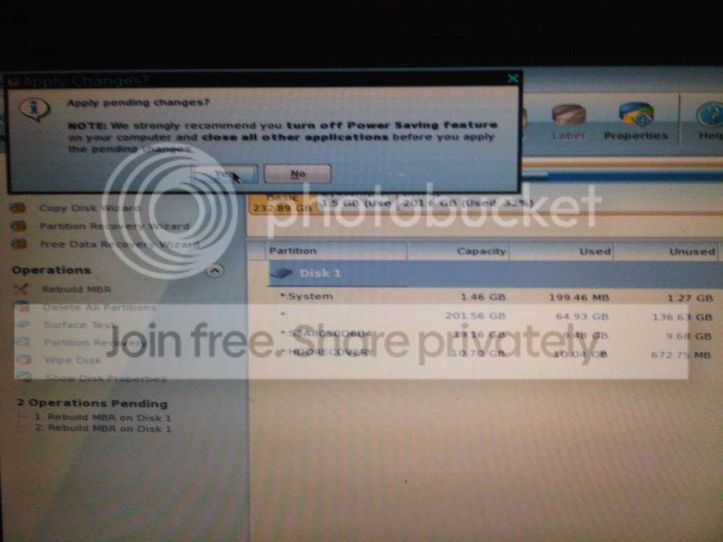

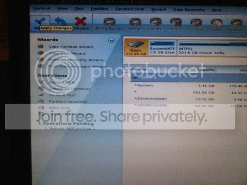

I selected the partition named *:System but when i go to disk then try to click Rebuild MBR it's shaded grey and won't let me

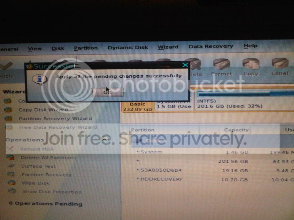

I selected disk 1 then rebuild mbr from there about 4 times already
it says it applied all pending changes successfully after each time
but how would i rebuild mgr on my system if it is greyed out?

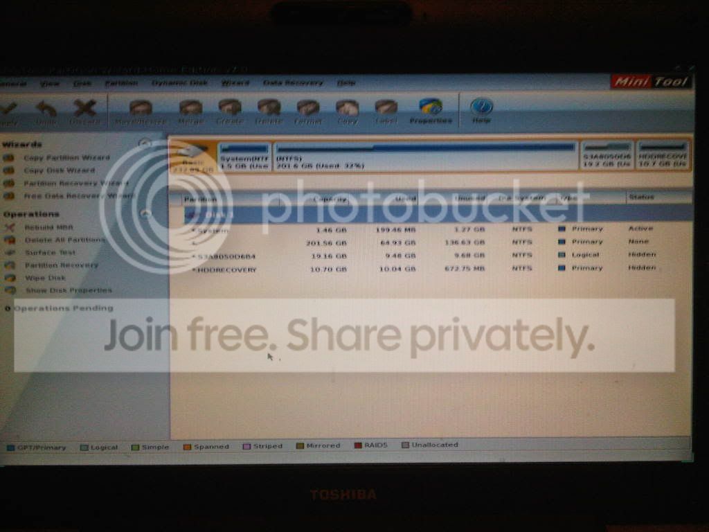

Can you post a camera snap of PW drive map with listings? System partiiton should be marked Active before click on it's HD to Rebuild MBR from Disk tab.
This may preclude the need to run Startup Repair - Run 3 Separate Times from Win7 DVD or System Repair Disk to repair or rewrite the System boot files to System partition.
If this regimen fails, move the Active flag to Win7 partition itself, but we need to see it to see that there are no complications, e.g. Logical partition that cannot be converted to Primary to accept Active flag due to 3 Primaries already existing.
Here's some camera pics
i've done this about 6 or 7 times already
when i restart afterwards it still goes back into the loop

Since your System partition lacks the System flag it needs to have the System boot files rewritten to it.
You'll need the System Repair disk or Win7 installation DVD. You can search for Win7 official ISO download online to burn with ImgBurn at 4x speed the WIn7 DVD which is good to have on hand for Repairs, clean Reinstalling Windows 7 or even rescuiing your files: Copy & Paste - in Windows Recovery Console.
If 3 Startup Repairs fail to start Win7 then boot back into PW CD to change the Active flag to Win7 partition itself, try Rebuild MBR and if necessary three Repairs again.
If these fail I'd copy out my files and run Factory Recovery from its partition or disks you made or order from Tech Support, or clean reinstall with the Win7 DVD.
