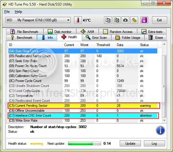

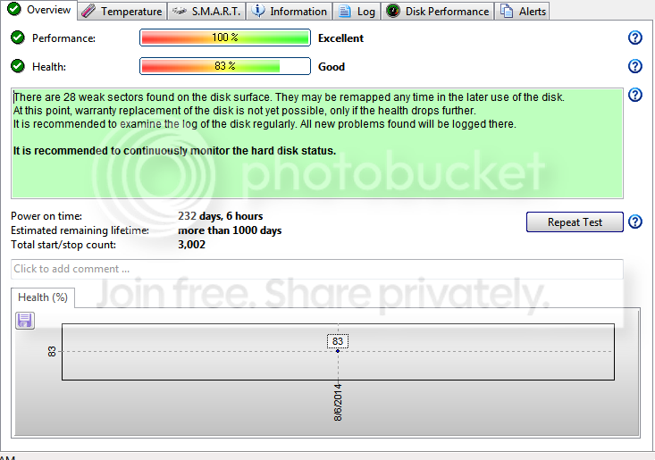

How to fix "Current Pending Sector Count" on WD External Drive
I bought a WD Passport 1 year ago, and I've tried to test it by HD Tune Pro and Hard Disk Sentinel.
And result are listed below:
How could I fix this error? I feel my drive doesn't work softly anymore :(
Thank you so much!

"Current Pending Sector" is a direct indication of the number of bad sectors waiting to be remapped ( remapping is the process of marking defective sectors are bad and allocating spare sectors from the reserved pool as replacement "Logical Blocks" ). Even one "Current Pending Sector" is a clear indication of failing media. Yours is 28 which is pretty bad and storing any important data on this drive is a risk. If this disk is only using as a media storage ( songs, Videos etc - not business critical documents ) , you can try to run an "Extended Test" using "WD Data Lifeguard Diagnostics" and it may force remapping of the pending sectors.
WD Support / Downloads / SATA & SAS / WD VelociRaptor
If the WD tool failed to fix the disk, i won't recommend using the disk at all. But you may choose to store unimportant data if you wish.
