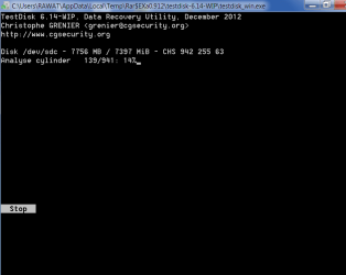

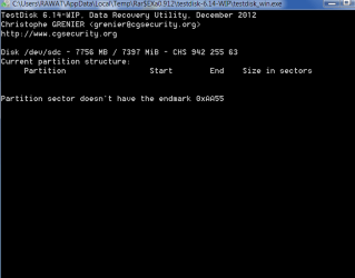

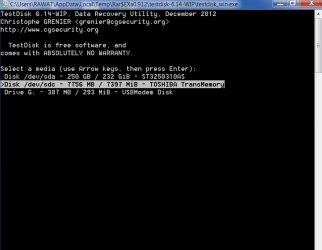

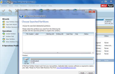

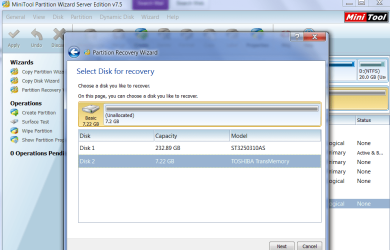

I Have a Toshiba 8GB USB that change into RAW file system, now windows don't recognize this. I have some important data on it. whenever i try to open this prompt a message "you require to format the drive."
I read some article on sevenforums.com, follow the instruction which shown in article but not Recover my USB.
Article link http://www.sevenforums.com/software...ive-turned-raw-partition-wizard-testdisk.html
I try with TestDisk 6.14 and mini tool partition wizard server edition 7.5 to get back my partition but not get success.
I am attaching some snapshot of my USB.

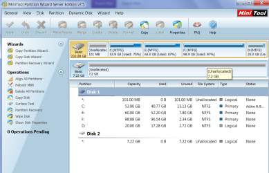

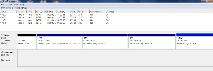

I am posting snapshot of windows disk management before and after inserting USB.

1. There is no need for the "before" screenshot.
2. After plugging in the pen drive, just take a full screenshot showing Disk 1 in it. That only carries the full information needed. I want to see whether it still reads RAW. ( Please do not click anywhere on Disk 1 to bring any other Window obscuring the DISK 1 drive map)
Your screenshot should look like the one below which shows my SanDisk pen drive Disk 1. Taken with Windows Snipping tool. Snipping Tool > New > Rectangular snip. Save as JPG in any folder you like and then upload.

@jumanji
There is no sign of USB.
windows 7 ultimate 32 bit

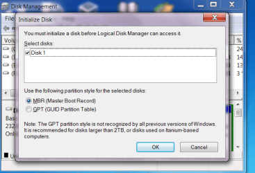

OK, Disk 1 is your pen drive. It is only showing as Unknown and not initialised with no capacity indication. It no longer shows as RAW. So recovery with Partition Recovery Wizard does not apply.
Do you still have Partition Wizard Server Edition on your PC? If so, plug in the pen drive, Run Partition Wizard and post a screenshot. Let us see how your pen-drive looks in it compared to the first PW screenshot in your post #1( the fifth Screenshot in that series). I am only hoping that it does not show as a BAD Disk.
( If you have already uninstalled the server edition, install PW Home Edition and do it.)
We shall decide on further course of action after that examination.
