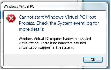

might be worth pointing out that Virtual PC now supports NON virtualising hardware: http://www.sevenforums.com/news/71841-windows-xp-mode-now-accessible-more-pcs.html as of today im running it myself on a non hardware virtualising processor
I just posted this on that thread:
Does anybody know if other virtual machines still need virtualization technology enabled? I mean, is this No-VT update something separate that makes XP mode to run without VT, but Virtual PC itself still needs it when other vm's are run?

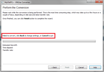

Got the download link from VMLite, installed MyOldPC Converter. Had to meet my real life friends, too, so I went first to pub. Back now, testing.
Very first, I just checked which file formats MyOldPC supports. After 30 seconds it was clear you can not use MyOldPC to convert your existing system or an image to any format supported by VMware.
See here. First, you can convert an image or existing system using MyOldPC to these virtual HD formats:
But to be able to mount a vhd to VMware, it has to be one of these formats:
(click images)
The problem is, MyOldPC creates virtual hard disk. But VMware needs a configuration file to mount existing vhd. These configuration files are only created when the new virtual machine is booted first time.
I really do not now how to create this settings file manually. These files contain so much individual information about vhd (MAC addresses etc) that it is not possible just copy it or write a new.
Next, i tried to convert an existing vhd to some other format. it was a no go, as this error message tells:
Next I tried to convert my second Win7 rig to vhd using MyOldPC. It worked, and I mounted it succesfully to both VirtualBox and Virtual PC, but this does not help you because you don't have hardware virtualization.
Next step was to download and install VMLite, and to try to mount the vhd I just created to it. No luck there, VMLite installation failed two times, I have no more patience to play with it today.
So our saga continues. This issue interests me quite a lot, so I'm going to test all possible scenarios. I have enough old comuters with different OS's, so I'll find something.

Virtual PC? And you have no VT support?

However, your problem was that because you do not have virtualization technology in your BIOS, you need to use an alternative virtual PC application, one which works without VT. WMware would be a good alternative, but it can not mount the vhd without existing configuration file (notice please: this might not be the case, but I have not found a way). Messages I've sent to other Seven Forum members who I think could bring something new to this our discussion have not answered.
But I think our, your luck is about to be changed. After you started this thread, Microsoft announced it has changed the policy regarding Virtual PC, XP Mode and the need of virtualisation technology. Virtual PC with XP Mode is now available also to computers without VT (http://www.sevenforums.com/news/71841-windows-xp-mode-now-accessible-more-pcs.html). I suggest you download and install Virtual PC and XP Mode one more time, in the mean time I test how we would go further from that.
Please notice this: Ýou mentioned earlier you have downloaded Virtual PC, only to get the error message telling it does not work on your computer. Before reinstalling, follow instructions in this post to check that both Virtual PC and XP Mode are not present in your system. Go then and download the Virtual PC and XP Mode again, do not use those files you've already downloaded. Notice that there are now three files to download, instead of two as it was until a couple of days ago: Download Windows XP Mode.
