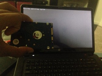

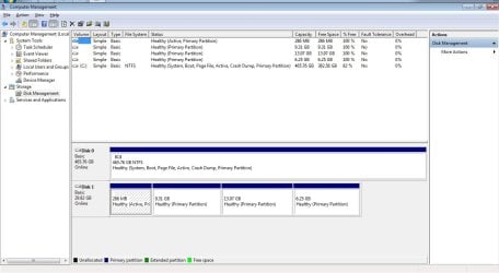

Hi all,
I'm running into BIOS issue with similar system configuration, I'm not able make the SSD bootable. I have HP EVNY with 500GB HDD (with Win7) and 35 GB mSATA cache SSD. Now, HDD is corrupted(works occasionally, if i turn off for longer duration). Hence, I'm trying to use only the SSD with Linux for time being.
1. When I removed the HDD, and installed Linux in SSD, while rebooting, I get a message "Missing Operating system". I don't see SSD in bios.
2. When I use bootable USB with Linux, I could see the SSD. or If I attach the HDD, I could see the Linux partition. Is there a way to fix this.
Attaching screenshot. Please help.
