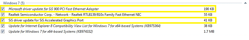

So I connected to the internet and did the windows update. I have attached what it found when I first did the update. It looks like windows found my SMC network card to be a "Realtek RTL8139/810x Family Fast Ethernet NIC".
Windows update did however found a working driver for the onboard motherboard. It found it as a "SiS 900 PCI Fast Ethernet Adaptor"
It also found a SiS Accelerated Graphics Port.

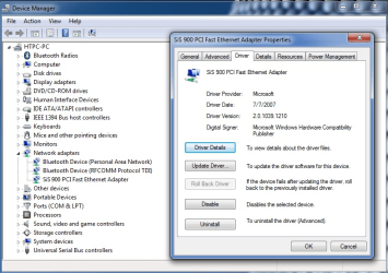

I have attached two screen grabs of what windows update finds after the first update and of the network driver details. If someone can tell me how to extract the driver I can post it here!

What is wrong with your Audio and Video card Drivers??..I look at the Device Manger picture and Windows 7 does not detect anything wrong?
