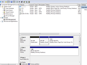

Also can you confirm that model number please as I cannot find any reference to the one quoted in the HP site. Plus can you give us a shot of the disk > Control Panel > Admin Tools > Computer Management > Disk Management and send the pic back so that we can see what there is on the C: drive. (see my pic)

I Had been using ubuntu for a couple of weeks (not going back to windows) so i deiced i didn't need it :l I Have also found out i can't screenshot so i took them from my mobile. Also what do you mean by can't find the model? Software & Driver Downloads HP Pavilion g6-1301sa Notebook PC | HP® Support
Recovery Won't work as i just deleted the ubuntu and installed windows. Screenshots will be added soon :)
