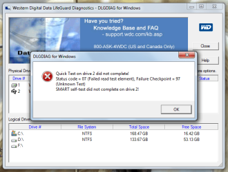

i already did the short and extended test. it all failed. does it mean there is no solution. but in the smart status it pass. ang properties says it is working properly.

If the drive if failing the WD DLG Quick and Extended tests, that would mean that it's beyond repair. If it's still in warranty you should start RMA http://support.wdc.com/index.asp?lang=en
However If you are not completely sure about the results you could post some screen shots here so we can have a look or contact WD Live support.

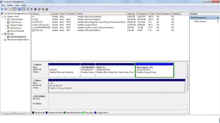

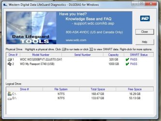

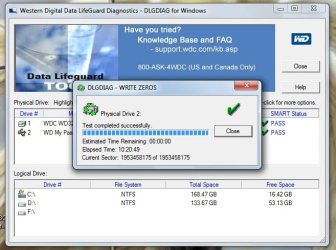

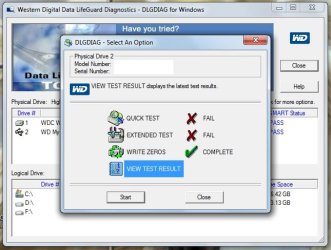

hi as u can see with my attchment i can completely format it thru write zero but not with disk management.
it failed both quick and extended test, but it pass the smart status.

I'm not sure why it's showing the SMART status as PASS, I guess it's because it actually could not retrieve the data ( the quick test is the SMART status), but this is not correct. I'm sorry to say that but this drive is unusable
