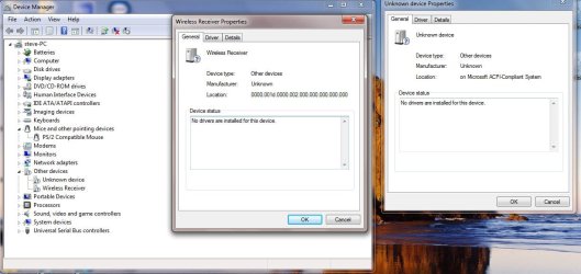

There isn't any down little black arrows and yellow !'s. But under other devices there is 2 small ? question marks. What it means, I don't know. I have never seen a question mark pop up like that before.

No drivers are installed, if those indeed are the items in your snips.
PLug them back into the other PC where they work, open those same 2 dialog boxes, what do THEY say under Device Status ?

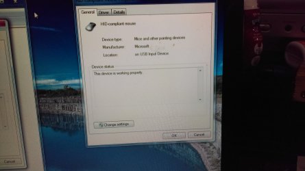

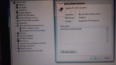

Here are the pictures from the HP Presario CQ56 device manager. There is no "other unknown devices" listed in the CQ56's device manager. By the way I picked up the CQ56 laptop cheap, for a song and a dance. It has a problem with the dc power jack were the ac power pack plugs in. Battery is good. I just have to put tape on the plug to hold the plug in the right spot to make contact. I am going to have to do a bit of jarry rigging until I can order a new power jack on Ebay from my Aug SSDI check.

Thats your baby.
Download the drivers to your desktop (extract as its a zip file).
Drivers ? Synaptics
Then open device manger update driver >> let me choose >> point to driver in extracted folder.

Roy which set of drivers? the "HID compliant mouse" or the "synaptic ps/2 touchpad? How can a wireless mouse and ganged keyboard be a touchpad?
