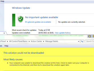

Naturally it fails via Windows Update too. Unexpected error, 9c59 (which a number of people have experienced).

Will have a look for the log file. Basically there are no incomplete updates, no outstanding failed updates, just some related to parts of Office 2003 I don't have installed that I've hidden.
Beyond that, I've been getting an Action Centre notification of some PnP driver that fails to download. I'm guessing that might be related to my EzCAP device, which needed reinstalling after a new install of Win7 and moving things with Laplink PCmover.

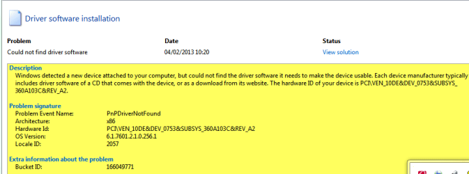

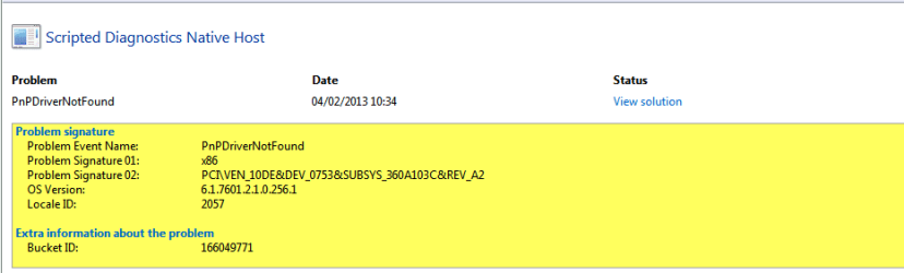

Oh, also there's been an annoying PnP driver report i can't identify, which always fails to download if I try..

What Anti-Virus is installed? - I see that the Windows Firewall is disabled, so what other firewall is running?
If you open Device Manager, and enable View > show hidden devices
do any devices show with yellow or red flags?
Which ones?

Hi...
- Bitdefender Internet Security 2013.
- no, no yellow flags in H/W Man, no issues.
Vista Ultimate 32 bit (EN)
HP G60 laptop
- that includes hidden items

You're not using SpyBot TeaTimer at all?
next time you get the PnP driver error, please note it EXACTLY.
Let's see if there's anything not-so-obvious amiss...

Hi, no Spybot, never in this Windows.
Attached screenshots of the PnP reports from Action Centre
Rest later..

The problem with the drivers appears to be NVidia-related - the Chipset drivers.
You need to go to the HP website and install the latest update for your computer from there.

The latest driver on the HP site for Win 7 32bit is this:
Graphics Driver for NVIDIA nForce MCP77MV Chipset2009-09-25 , Version:8.15.11.8644 A, 176.72MThis package provides the graphics driver for the NVIDIA nForce MCP77MV Chipset in the supported notebook/laptop models and operating systems. This driver enables graphic display and provides a user interface to access display properties.
- I noted in my post I'd updated the graphics driver - actually twice- via Windows Update, as I had noted the likely dependency from the articles I quoted.
However I think it may be some time- if ever- that appropriate drivers are released for 2-3 year old notebooks for IE10, if that's the issue.
