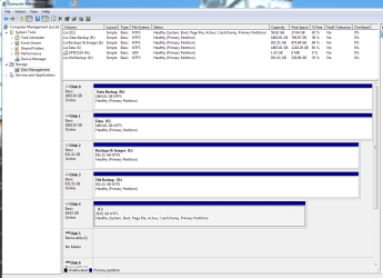

- to do away with the 100MB partition altogether. I used method 3 in the guide and so far it's worked a treat. BTW there is an error in the article - the 100MB partition is also automatically created in Windows 7 64bit Home Premium as well. My OS is now in the System, Boot, Page File, Active, Crash Dump, Primary Partition - all of the SSD. I believe this is rather like Windows XP used to be.
So beforehand Disk Manager looked like this:
and now like this:
Anyway Volume Shadow Copy seems to no longer be having problems, system restore works, imaging works - even Windows Backup imaging works (Except mine now wants to image my S: drive as well as the C: drive - I suspect that is because I have changed the location of all the User files (music, photos etc) from C:user\xxx to S:user\xxx and there must be some system files in there...)
