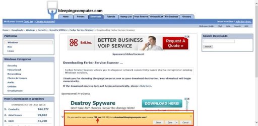

I like arrows. I'll go back to work on this.
