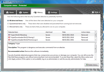

While searching for a solution to a problem poster here on sevenforums I found an answer that was close to what I needed, it was on another tech forum. Only thing was as soon as I closed the page down I was informed by MSE that I was infected.
After a full system scan, and some 750,000 files checked it reported to have remove 3 severe threats.
I then thought I'd check Task Manager to see if anything untoward was running and to my surprise I was faced with several processed with an 'Installer' description. Needless to say I immediately killed all suspect processes and deleted all temporary files from both
%systemroot%\Temp
%userprofile%\Appdata\Local\Temp
I then performed a reboot and all seemed well until the processes appeared once again so I downloaded MalwareBytes and performed a Quick Scan and again, I was faced with threats.
Below Is a copy of the log...

Quite a lost really as I'm a very careful browser.
I have one main question...
If MSE detected a threat file after closing the browser page why did it not detect that the file was attempting to be downloaded to c:\windows\system32?
From that stems another one...
Why did it then allow for other files to embed themselves into Task Manager Registry and my temp locations?
Is it not the job of AntiVirus & Internet Security to do exactly what their name intends? Especially as 1 of the severe threats was months old (see info below).

In answer to your questions I got it cleaned up very easily ;)
As I run a company that deals with Cleaning/Removing Viruses & Malware, and General PC/Laptop Maintenance I'm more than well aware of the dangers of hidden infection it just bugs me that no matter what AV software you use, something will always find a way in, it's inevitable.
I'll stick with MSE as I still hold it in high regard and will put this down to another forum getting hijacked.
With 20 years dealing with this sort of crap you still never get used to it ;)
