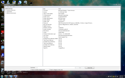

Installed memory (RAM): 4.00 GB (3.75 GB usable)
If you have a GPU and 64bit (rather than an on-board), it will show nothing. A GPU uses only address space and in a 64bit system there is plenty of that. An on-board uses real RAM. And that's what is missing in the OPs system (or at least he thinks it is missing).

Why don't you check in msinfo32 > Components > Display

Not really sure what I'm looking for, but under display I don't see the words "integrated" or "on-board" anywhere.

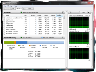

Both of my machines show the full amount as usable, 8GB on my main rig and 4GB on my HTPC.
There must be something like "Name" and "Adaptor description". Why don't you post that or make a snip of the window.

My situation is I have a GT240 board, which has all the memory it needs, and needs no aperture in system RAM. Therefore, 8GB installed, 8 available.
